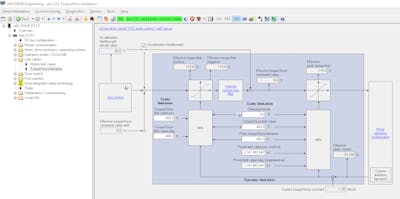

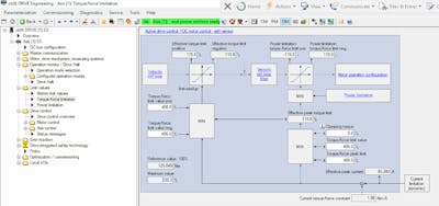

Question 1:
There is a difference between the limit of S-0-0082 in Analyse mode or viewing on the drive 400% or 220%. See also table 1 for the 2 screenshots of the various situations. How can i find in Analyse mode the maximun power output.

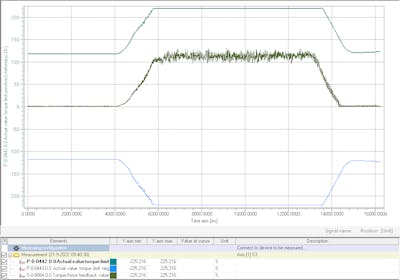

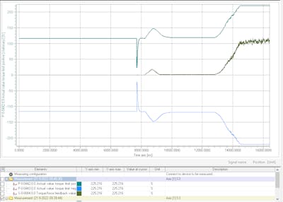

Question2:
What we see is a limitation in P-0-0442 and P-0-0442, this value is variable when the drive is operating. How is this managed? Does it check the DC Power and/or Drive/Motor temperature to set the correct limit value? See scopes in tabel 2.
We have multple CtrlX drives on the DC bus, is the limit always 220,2% or is it depending to the DC bus power how much torque is available.
Real mode give a limit in S-0-0082 off 220.2%
 Analyse mode gives a limit of 400%
Tabel 1
I have scope the value for P-0-0442/P-0-0443 with actuel torque value S-0-0084. The limit value is changing to a maximum of 220.2%. Only visible in online mode on the drive. How is the torque limit controlled/Managed?
Enable drive (first peak) and drill a hole.
Drilla  hole with drive enabled.
Tabel 2

To question 1: As told a thermal model is calculated all the time in the background. To see what the result is you have to look for the parameters P-0-0444 and P-0-0445.
To question 2: As told a thermal model is calculated all the time in the background. It is as well dependend if you already are in field weakening or not.
