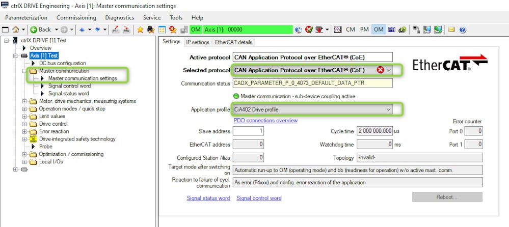

Unfortunately EtherCAT CoE protocol cannot be selected via the panel. At the very moment it could only be selected via ctrlX DRIVE Engineering, see.
Mind that after change of master communication a reboot is necessary.
