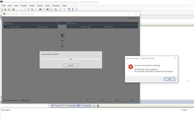

Have you ever upgraded your CtrlX DRIVEplus with embedded CORE? I have upgraded the Drive to AXS-V-0404 and the CORE to 2.2.1.
I can access the Drive via USB-C cable and jog the axis (no problem), but using the CtrlX I/O Configurator (V2.2.1), the EtherCAT Master can no longer find any EtherCAT Slave.
I really don’t know if the Master Communication ports of the drive got defective after the upgrade to the latest version of firmwares.
Is there any incompatibility with the current hardware I have in hands (too old hardware for such new runtimes) ?
Please, check the screenshot below.
Thanks! 😊
Sorry for the late reply, lost track of this issue.
There is no incompatibility known for your hardware and software combination.
An error (F8115 firmware inconsistent) after updating one part of the firmware is just normal. Please also notice that a hard reboot by switching of and on supply voltage is necessary after finishing both firmware updates.
