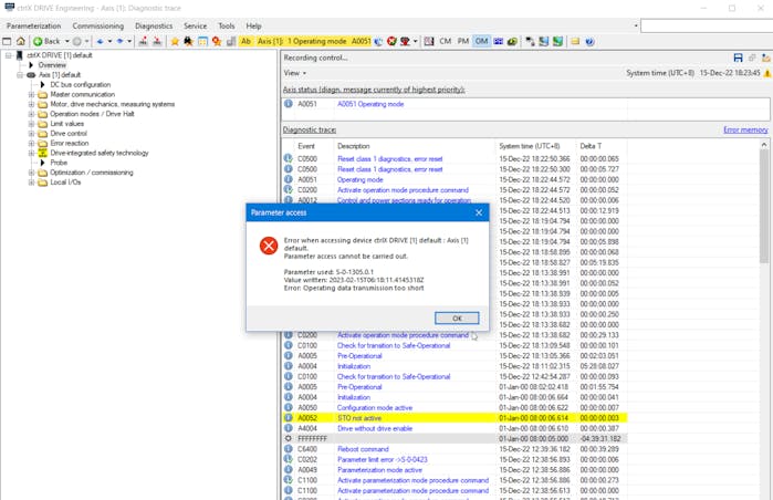

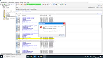

I am using ctlX drive demo unit, when i click the system time to sync the ctrlX drive time an error popped up "Error when accessing device ctrlX DRIVE [1]: Axis[1] default. Parameter access cannot be carried out".

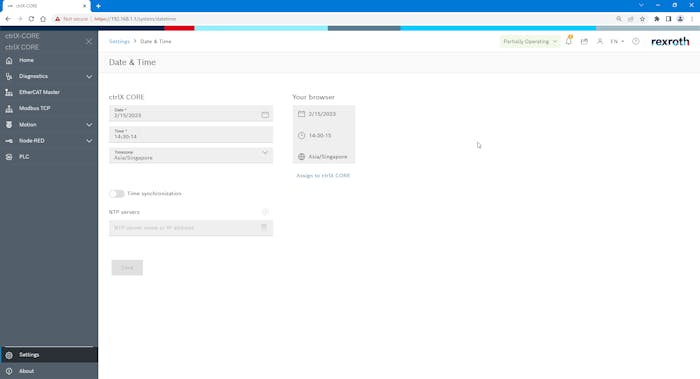

ctrlX date & time:
My ctrlX version is 1.18

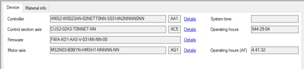

Just tested with theΒ LTS version 1.20 with drive firmware v402 the system time will sync with windows by itself, when i click on the system time it will show this:
i think this topic can be closed since the time will sync with windows by itself.
