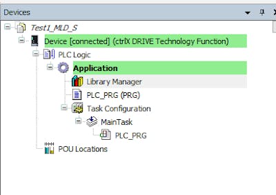

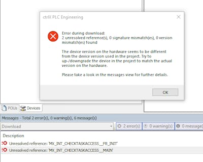

Hello ,
Compiling of PLC programm in ctrlX Drive technology functions is OK but when downloading we get the error :
How can this be solved ?

Problem is like written in the pop up screen that you want to combine an old firmware with a new device hardware. Please update or use the correct firmware. If you need assistance in doing so please address to your sales or engineering supporter.
