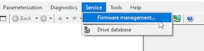

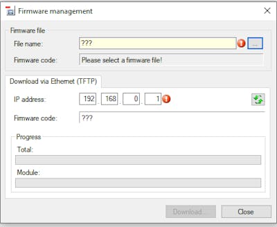

You can only try to connect the drive over the firmware management, see screenshot, and load the firmware 02Vxx.
