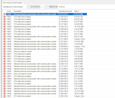

they noticed they loose communication up to 2 times per day.

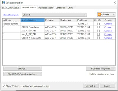

when they have the communication interruption, the drive appear in "Rescue System" mode, with the default IP adress : 192.168.0.1, which create Duplicte IP Address in the network.).

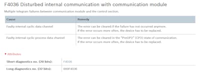

Hello.
The error description says that this is probably a hardware defect and therefore the device must be changed. Please contact Service and arrange an exchange.
