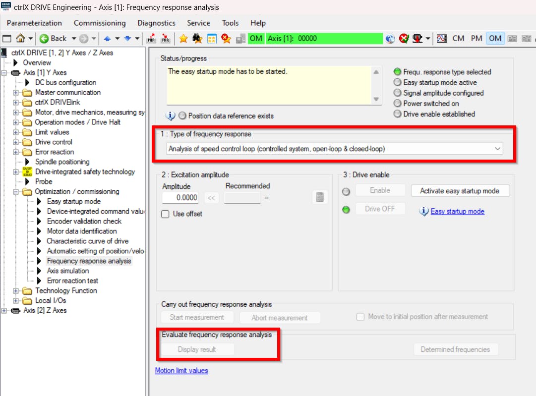

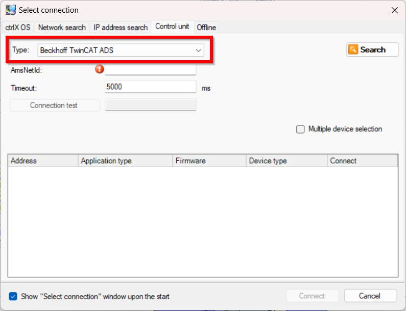

We use CtrlX drive engineering V1.28.3 with CtrlX firmware V04.02.4. When connecting the CtrlX drive engineering trough the Control Unit Beckhoff ADS to the drive the interface is slow and loss of data during FRF analysis Controller system, open loop, closed loop.
When opening display result the controlled system graph is not shown in the data without any error message.
When switching to connection type EoE or USB connection the data is shown correct as expected.
