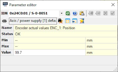

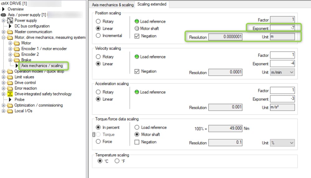

When linear scaling type, the position value does not reflect the same in the ctrlX DRIVE and TwinCAT
ctrlX DRIVE:

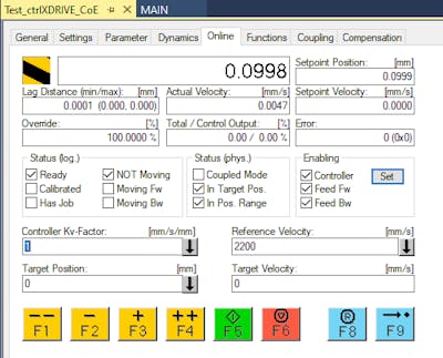

TwinCAT:
When I try to modify the encoder resolution in TwinCAT to match the values of the encoder, the axis doesn't move smoothly.
Could you tell me if some configuration has to be set on the TwinCAT side in case of linear scaling?

Please send the parameter file for evaluation. But looking to your screenshot of the actual position (0x24C0:01/S-0-0051) this is a very poor resolution using 0,1 mm.
You may adjust it in setting
