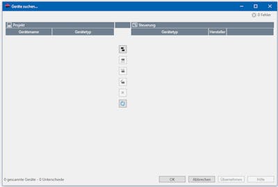

I tried to connect my ctrlX Drive (XMS1) to the ctrlX Core. I used the HowTo from CodeKnecht and the YouTube Video from ctrlX DevelopR. But the ctrlX Drive can't be found in the IO Engineering App (Picture below).
Anyone has an idea for a solution? What are typical mistakes in that case?

Please also first check your cable connections: ctrlX CORE out = XF50 and ctrlX DRIVE in = XF21.
Have a look in the how to collection in the drive section how to generally connect your PC to a ctrlX DRIVE. To check the communication setting connect via the additional display or directly connect your PC to port XF20 and try to connect there.
