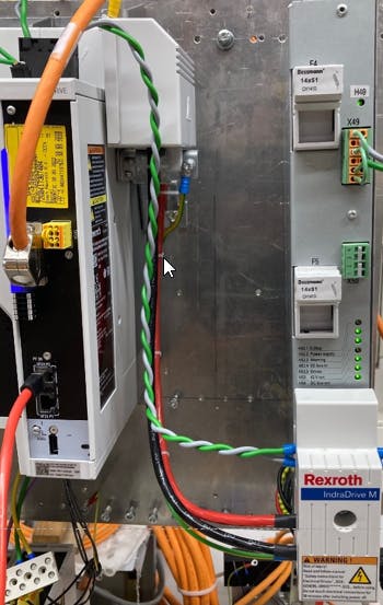

is it possible to use an XCS as a drive module with an integrated core and as a power supply for IndraDrive Mi?
Best reply by Drives_Uwe
This is possible. For connecting the DC bus best use the XAS4 accessory to connect the KCU unit, see picture.
