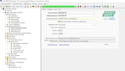

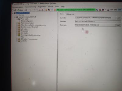

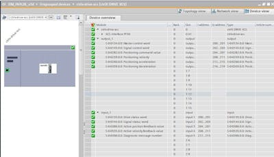

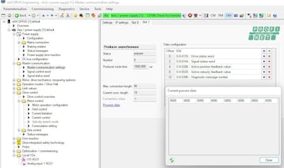

I have a problem with controlling the ctrlX Drive XCS via Profinet.
 The connection is established, everything is green in TIA Portal.    
The driver it was firmware FWA-XD1-AXS-V-0308N-NN.03.  
 I replaced : FWA-XD1-AXS-V_0312N-NN.00 but nothing change in communication....
The parameters are attached.
Thank you in advance for your help.

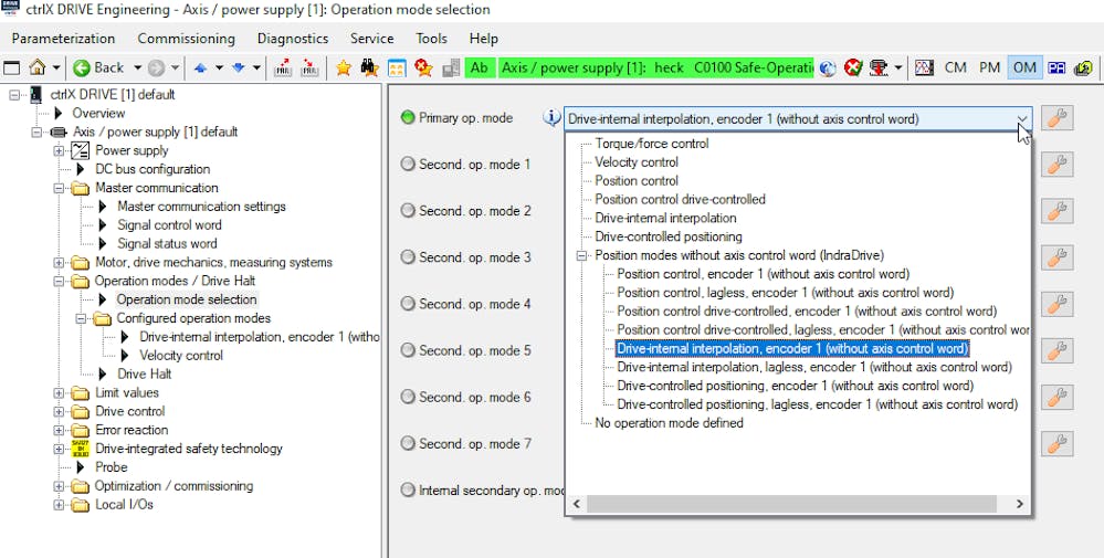

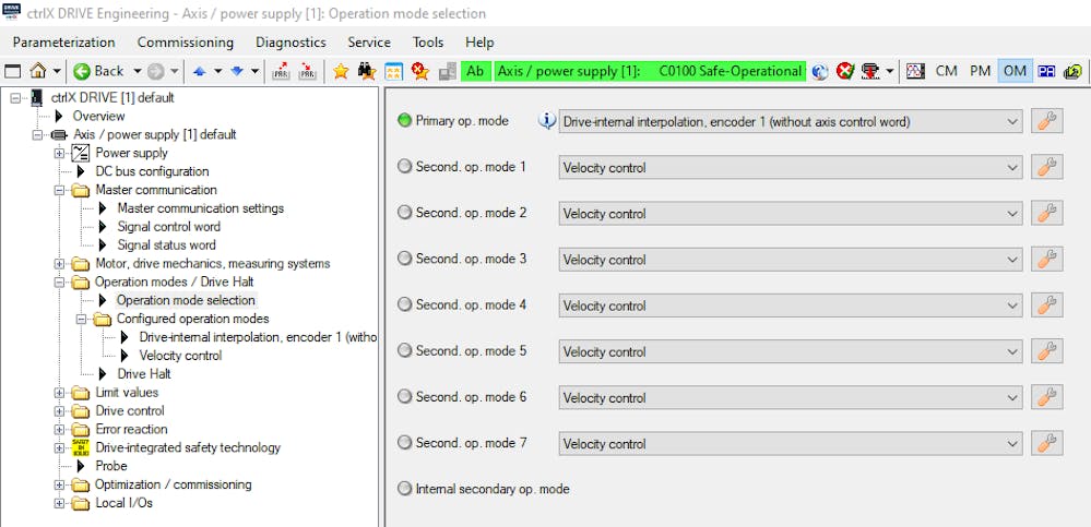

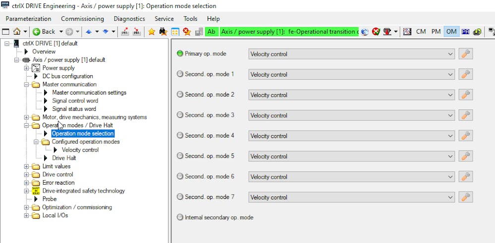

Please set the operation mode according to your cyclic data which you exchange from the SIEMENS control to the drive:
From today´s settings:
to:
