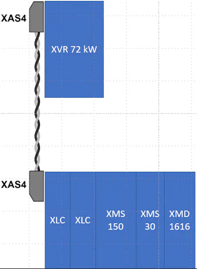

just a clarification regarding XAS4 accessory for multi line arrangement: my configuration is like this:
Based on the documentation I would need qty 1 XAS4-WM-U005-NN at XLC side and qty 1 XAS4-WL-U005-NN at XVR side, correct?
Then because of the XVR 72 kW I would use 70 mm^2 cable cross section.
70 mm^2 cross section seems to fit just in the XAS4-WL-U005-NN accessory but not XAS4-WM-U005-NN, how to deal with this situation?
Best reply by Drives_Uwe
I would recoomend to place the XMS 150A connected over the XAS4 and have the XLCs at the end of the line, like
XMS 150   -   XMS 30   -   XMD 1616  -  XLC  -  XLC.
The  you can use 2x XAS4-WL-U005-NN
