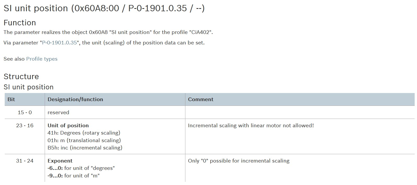

When the drives are in CoE configuration, there are CiA402 standard objects that take precedence on the scaling.

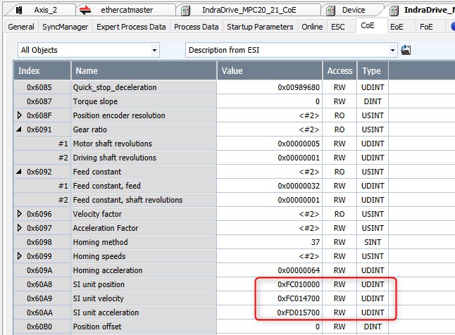

You need to set CoE Objects 0x60A8, 0x60A9 and 0x60AA in order to specify your range. You can change them in the CoE tab of IO Engineering, or set them via startup parameter lists.
