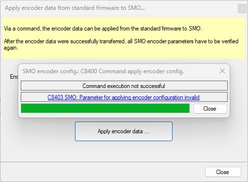

C8403 SMO: Parameter for applying encoder configuration invalid
I'm trying to configurate SMO in the ctrlX Drive (M8) but when I Apply encoder data appears this problem:

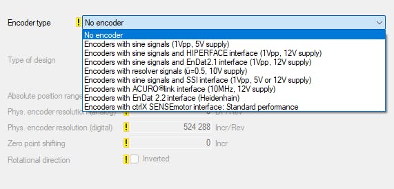

Also, I saw the list of encoders that are acceptable to configurate the SMO:
But the encoder of my drive it doesn't appear. Is possible that is the problem?

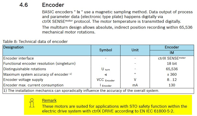

The encoder of my drive is:
I'm using the 6.4v to the drive and the 1.32v to the ctrlX Drive Engineering.

the ctrlX sense basic performance can not be used as a safe encoder, only STO is possible
regards,
Stefan
