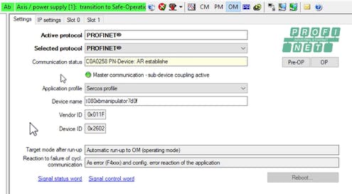

Our customer has got a problem with controlling the ctrlX Drive XCS via Profinet. The connection is established, everything is green in TIA Portal, everything looks good there and in IW DS15:
He has got the FWA-XD1-AXS-V-0308N-NN.02 firmware now.ย

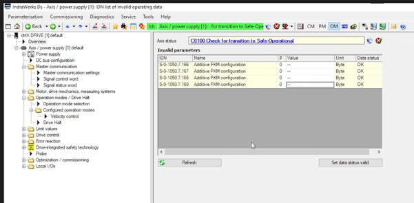

There is an error like this: C0100 - Check for transition to Safe-Operational and it is still present, it can't be cleared.
The invalid parameters looks like this. We were clicking "Set data status valid".
