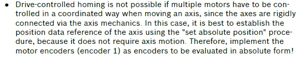

However,Section 7.1 of document "R911420702_02" contains a description regarding the encoder, as follows:
Therefore, I would like to know whether incremental encoders—such as sine-cosine encoders—are suitable for use in gantry handling systems?
