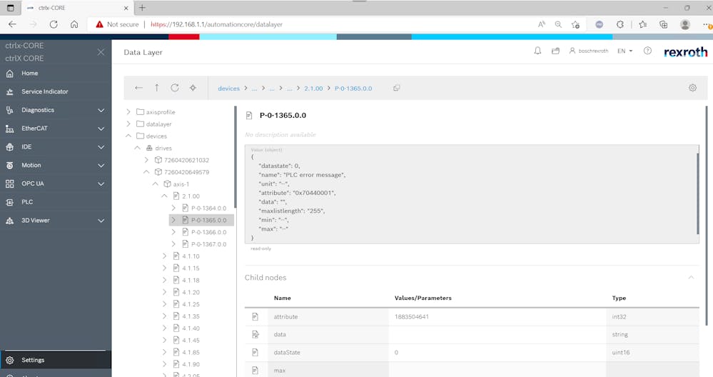

  1. Via the DRIVE Connect App:
    ctrlX CORE Data Layer drives

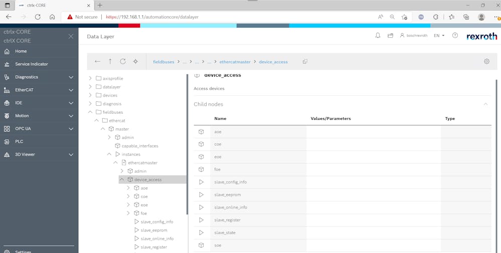

  2. Via the EtherCat master:
    ctrlX CORE Data Layer device access
