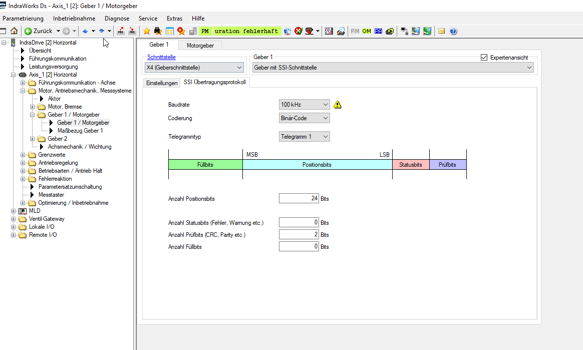

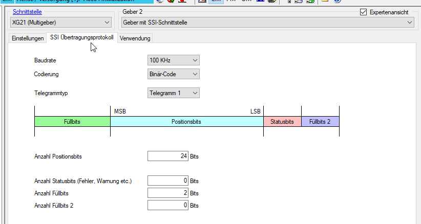

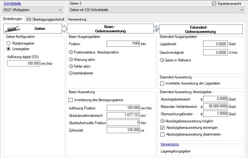

2 Codeur, CtrlX Drive, Problem with the second codeur
on an HCS drive, the second encoder works, when I transfer it to the CtrlX Drive.
there's an error.
HCS in mm and CtrlX in nm
Someone could me helping?
CtrlX:
FW: FWA-XD1-AXS-V-0308N-NN.03.fwa
Drive: XCS2-W0023ARN-02AETM5ECNN-S0308N2NNNN3NN
Best reply by Drives_Uwe
Problem was fixed after changing the clock rate of the SSI encoder to 400 kHz.
