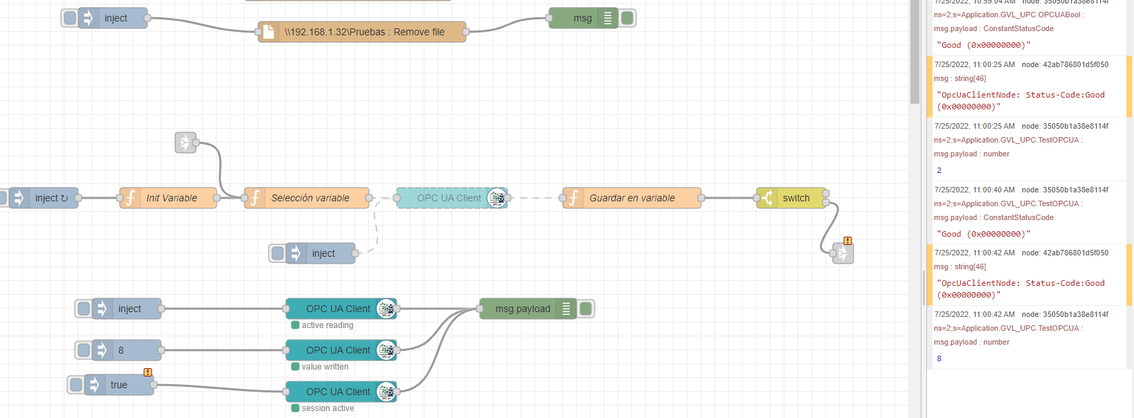

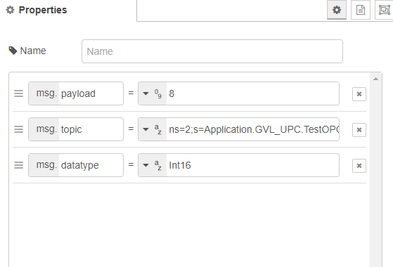

Hello Sgilk,
You have to put the Datatype back in the node injection, or use the OPCUA Item. I have tried it with an Int16 and a Boolean and it works.
Regards.
