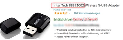

Hello Lauri,
we will release most likely the Wifi usage as Accesspoint/client by RM2207.
The handling for configuration is currently not supported by our web-ui. Manually setup with rest-api gets necessary to modify the default (client mode).
Please consider that 2 WiFi USB devices are supported right now but NOT both of them support AccessPoint-mode connected on the ctrlX.
The NETIS Wifi supports both Opmodes
The TP-Link provides only client mode in connection with the ctrlX.
Take care ording the exact type... other chipsets are not supported by the ctrlX-integrated drivers.
Bye
