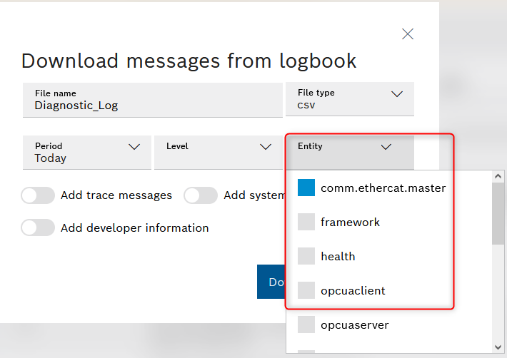

To monitor the cause of occasional EtherCAT communication disconnections.ย  We activate the persistent logbook of ctrlX CORE.
One days later, a log of file is recorded. Inner the log files, it's full of invalid infomation for us. How to aviod this? We just want to record some error from motion/ethercat/plc and so on.
Best reply by JoK
you can try to filter the logs before generating/downloading them (see screenshots), this should decrease the amount of logs
