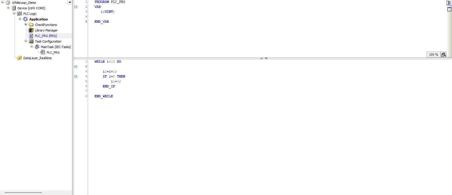

Hi I tried to execute the sample code below but i kept getting stopped out by watchdog feature.

by operating with WD you avoid the topic. Means the WDs - even with expanded setups - will provide more access of the ctrlX.
Running the system without WD into a endless-loop will cause high  load on the core the PLC-Task is calculated and all task with lower-Prio will be suppressed. Communication of the web-sites is effected etc. Trying to get in contact with the ctrlX-PLC Eng will run in Timeout-topic.
Goal would be natural to bring the PLC in Stop. Remember the Endless-loop is not a bug in terms of system-behaviour.
If a) the PLC-website can not be loaded,
b) the PLCEng is not connectable the Rest-Api be supported.
If not - the deactivation of the PLC-App will be possible, even several trials may be needed to trigger the switching to 'Service' - mode.
Activating the PLCApp again will bring the PLC in Stop-mode.
Low load will the result - connecting with PLCEng is possible again. Flashing the image can be avoided by that!
