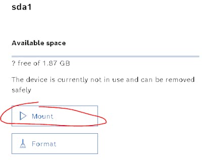

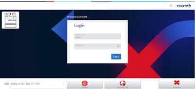

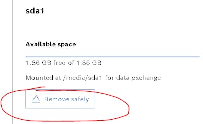

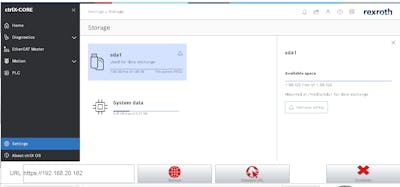

Right now,  I found another way to get it working. It's not what I'd like to have but good enough to have a first solution:
With my own Visu (CoDeSys WebVisu) I placed the "webbrowser" element and browse to ctrlX OS Web infterface.
In ctrlX OS Web Interface there is a new user "user" with restricted permission just to manage "storage".
There the user can "mount"/"remove" a USB storage device.
With that, I reached what I wanted to have:
-Customer / user musn't start a webbrowser or call another page
-Customer / user can do it from my Visu
-No further code, software, program or anything is needed
