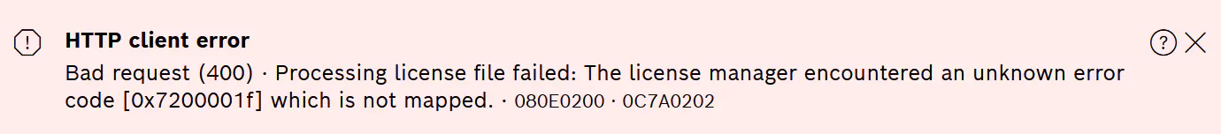

Hi, i have been trying to upload a trial license bin on my ctrl x core this morning and it is not working, it displays me this type of error
even the process of downloading it and assigning to my device from the device portal was not working but after a few tries it finally did. i assume it is probably the server or something like that, right?
thank you in advance
Best reply by nickH
The issue was Device Portal related. During the time the license-bin-file was created there were technical problems with the device portal. So likely the .bin file downloaded yesterday was corrupted.
A freshly downloaded .bin file this morning worked well.
