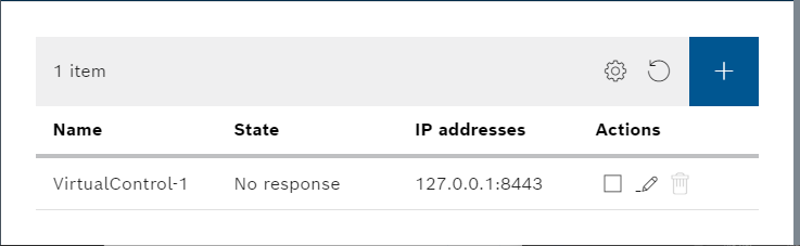

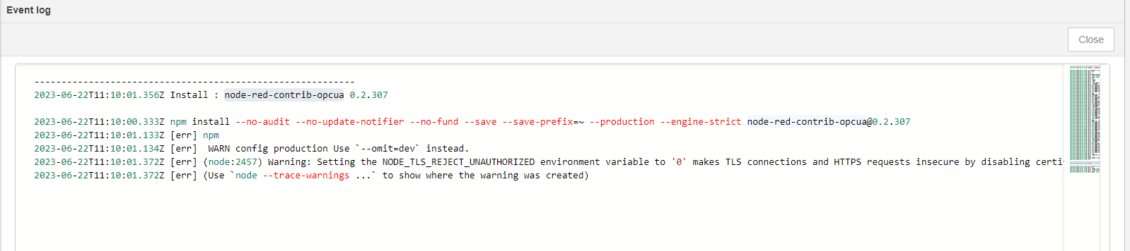

I am trying to install node-red-contrib-opcua in my Node-red. After starting the installation within 1 min the state of my ctrlX Works goes into No response mode. I have tried waiting for a few minutes, still nothing happens, and I have to restart my ctrlX to acces it again.
I have a working internet connection in my ctrlX, and the date and time also matches my bowser. I can install other nodes, but for few nodes I am facing this issue.
I have attached pictures for reference.

This issue is solved, the "pxi.ini" file was not configured properly which was causing the issue.
