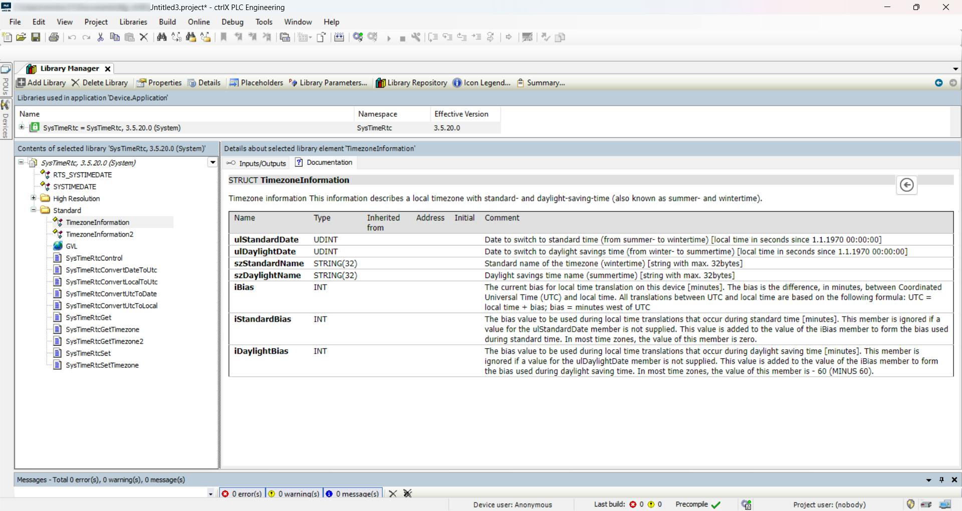

I am not quite sure what you mean by no connection to a ctrlX CORE. If you are using the ctrlX AUTOMATION - PLC app that is running on a ctrlX OS (in standard installed on a ctrlX CORE) the library function will get its time from the operating system. The system time is buffered by the battery mounted in the ctrlX CORE.
Please have a look to the documentation of the function block itself in the library manager inside the ctrlX PLC Engineering to get to know more about the data given back by the function block:
ctrlX PLC Engineering - Library manager - SysTimeRtc - STRUCT TimezoneInformation
