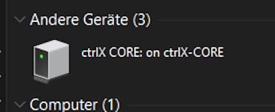

Hello together,
I can't see the ctrlX Core in PLC and Works. But I can see it in the network overview. I am also be abled conneting to the Core.
Are there any possible solutions for that issue?

We had some problems with class C networks in the past. What is your IP settings? And which firmware version is installed (e.g. 1.10)?
A workaround would be to give your control a fitting IP like 192.168.1.1/24 as well as the PC e.g. 192.168.1.12/24.
