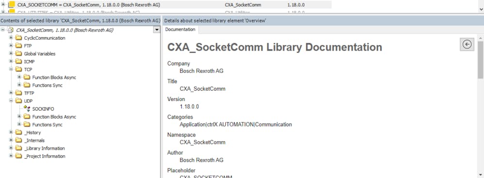

PLC Based:
  • TCP, UDP, FTP, ...: CXA_SocketComm library (Rexroth)
    ctrlX PLC Engineering CXA_SocketComm

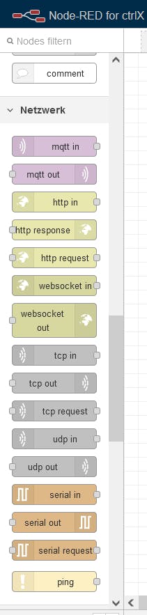

ctrlX Node-RED app based:
ctrlX Node-RED network palette
