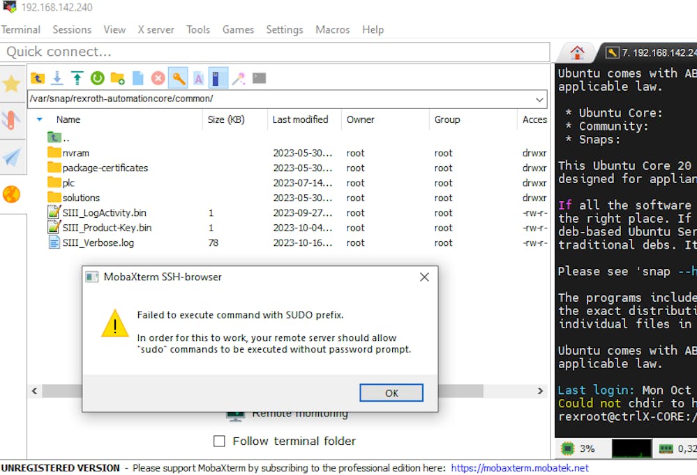

SUDO prefix from MOBA XTerm suddenly doesn't work anymore
For months the SUDO command prefix from SSH Browser in MOBA XTerm is working fine. Suddenly I can't do some SUDO more from the SSH Browser, e. g. to delete a text file.
I can't find any settings in the ctrlX Core UI how to enable the remote SUDO command prefix.
Anybody can help?
Hardware: ctrlX Core X3
Operating System: Ubuntu 20.04 Focal
Please keep in mind that root user assertions (and so ssh access) are in standard time limited to one year. Afterwards it will not be usable anymore.
