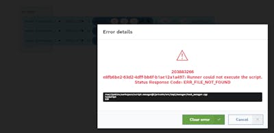

I am trying to move a virtual Kinematic in CtrlX Virtual.
The program compiles without issues, but when I try to start the code I always get the following error message:

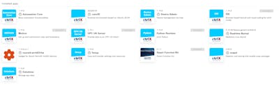

Deploying to Target seems to work as well. I have the following Apps installed running with an empty configuration with only the Axes set up.
What could be the issue here?

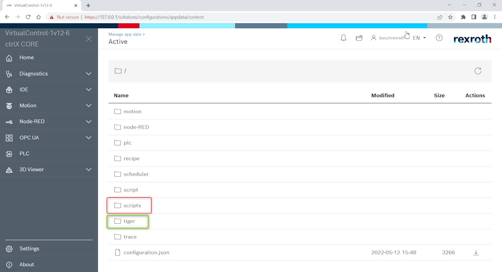

After some investigation we found that the scripts folder (containing dependencies for the IDE app) in the app data was missing. The tiger folder includes the project data of the visual coding:
app data scripts folder
The solution was to uninstall the IDE app and afterwards install it again.
