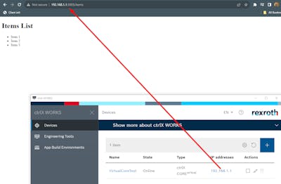

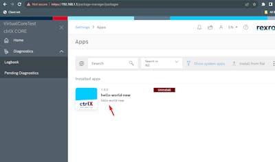

I have a web based app written in nodejs and I built the snap application of that project. Then I have successfully installed that snap app in Virtual Ctrlx Core.
The project has different routes and APIs in it, how I can run that installed project?
Best reply by jawad
Thank you nickH
I have achevied this by runing the ip address with port no. and route which is defined in code. it works .
