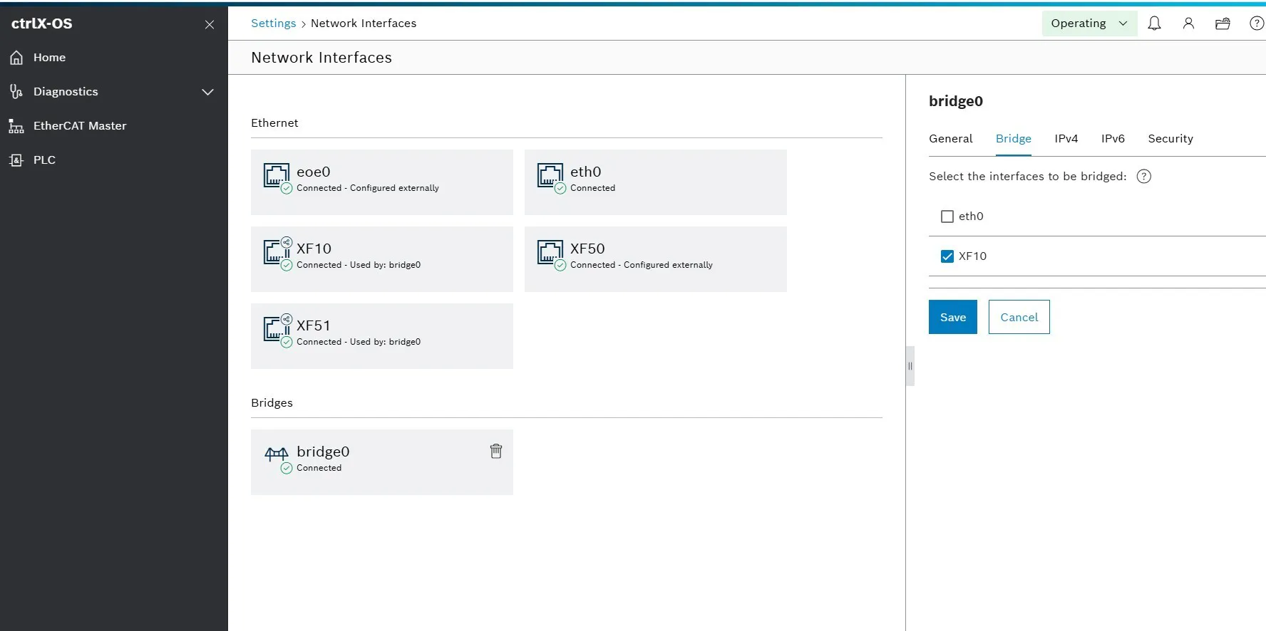

Remove XF51 from bridge0 not possible
I cannot remove XF51 from the bridge as there is no checkbox for it. Only eth0 and XF10. Is this a bug?
Best reply by nickH
Update:
I just found the information. This is a known bug. It will be fixed in V4.6 and in V3.6.6 of the Device Admin App.
Thanks for reporting.
