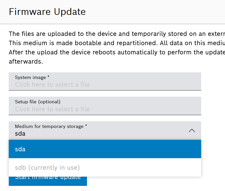

our CtrlX X5 runs actually with the firmware V2.4. Now we want to update this CtrlX to the newest firmware V3.6.2. We want to do that remotely beacuse it´s way more efficient for maintance. We already inserted a USB-C-Stick in the port XF01C. We also have downloaded the file "X5_X7_Systemimage_3.6.2.zip".
Where I can find a detailed description which file of the zip-file we have to select for the system image update?

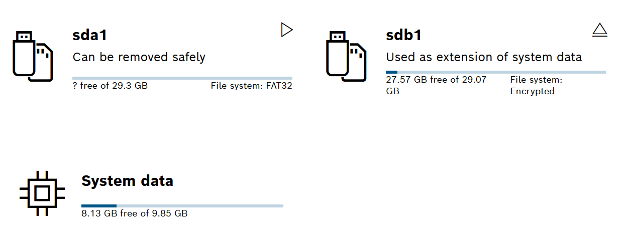

Furthermore I mounted the USC-C-Stick (SDB1) for the firmware update, formatted it to FAT32 and used it as extension of system data. Furthermore we have a SD-Card (sda1) in use for data exchange (currently unmounted). However we can only select sda for the firmware update.
