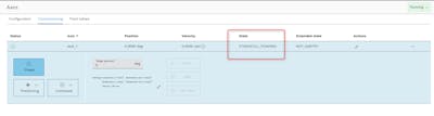

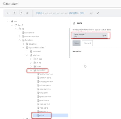

I can enable the drive but gets stuck on StandStill Pending. I checked Status word and looks fine. Another thing that i noticed is the Actual Position only updates once and then stays same value. I checked this with Elmo software being online.Ā
any suggestion on what the issue could be?Ā
