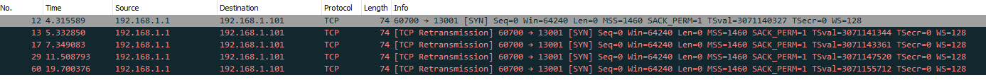

Therefore, I created a few samples to execute tests and got the following result: The connection with TCP works if the ctrlX is the TCP server. In the case that the ctrlX Core is the TCP client sending data to the host machine, it won’t work. I’ve tested having both the TCP Server and Client on the host machine as well as accessing the TCP Server (on host device) from another machine in the network without any problems. I’ve also looked up the network traffic with wireshark and saw that the package was sent to the host machine, but no answer is sent back, but with any other device, the answer will be sent. If the server isn’t started, the host machine sends an answer/ack so that the ctrlX Core logs that no one is listening on the socket. The ports on the host machine are opened.

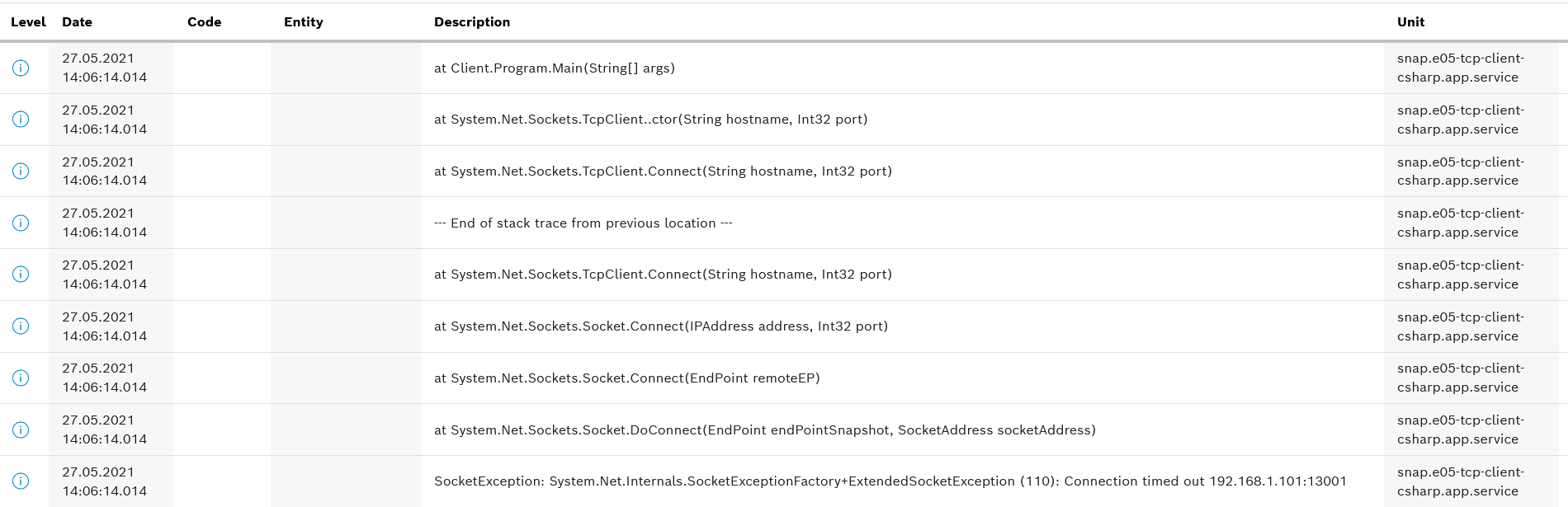

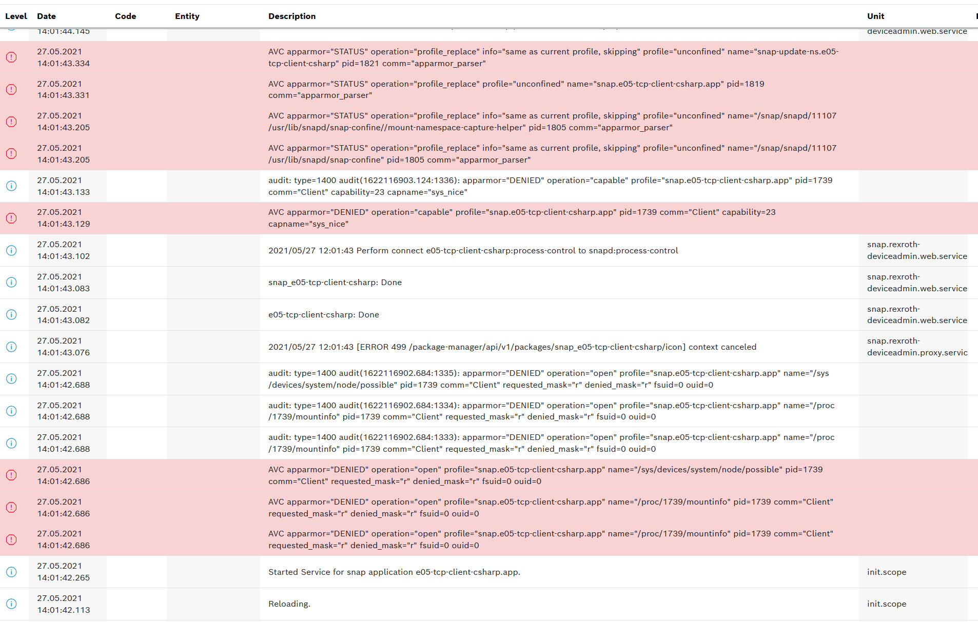

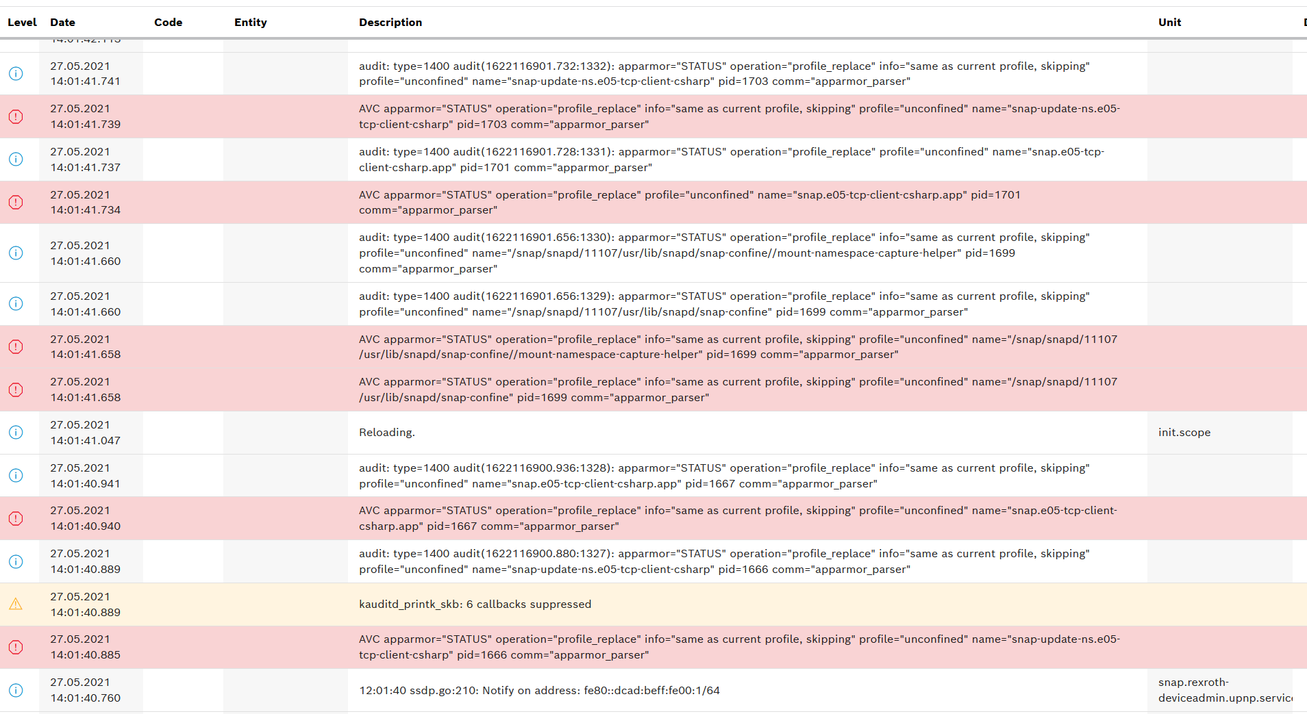

After I installed the TCP Client App on the ctrlX core, I get several errors of apparmor, but I don’t know how to solve them or if they are the reason why the example app doesn’t work. If I stop the server on the host machine, the application logs the expected socket exception (Connection timed out). After I start the server the network package is sent but no answer/ack is send back.
The TCP Client and Server are just the Microsoft Documentation examples (Server, Client) with changed ports and addresses. I’ve provided also screenshots of the ctrlX log, as well as the wireshark insights. I can provide the specific source code or other details if necessary.

After a lot of tests and modification in the firewall, I found the problem. It was due to outdated firewall settings (probably created during the first tests). I had tested the snaps on a real ctrlx core and initially encountered the same problem, but was able to solve this in the firewall through appropriate settings, as discussed at yesterday's appointment. After taking a closer look at the firewall on my computer locally, I noticed that there were still outdated settings. After I deleted the old settings and adjusted the new ones according to the working example, the TCP server on the host device and the client on the ctrlX core (virtual) worked without problems.
If someone encounters same or similar problems, check your firewall settings. The following settings worked for me: Create an firewall inbound rule and change the protocol type (under protocols and ports) to TCP, set Local port to 13001 (or the one of your TCP server port) and leave remote port with all ports. Set the Remote IP Address (under Scope) to the IP Address of the ctrlx core (virtual) and specify the profiles (under Advanced) to private and public.
