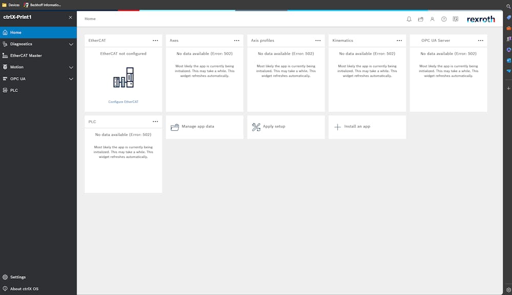

Very often lately, while I'm downloading the PLC program, the ctrlX goes to a strange "Service Mode" where every app is unavaible from web UI and I can't perform any operation to the ctrlX (I can't see the OPERATION/SERVICE flag).

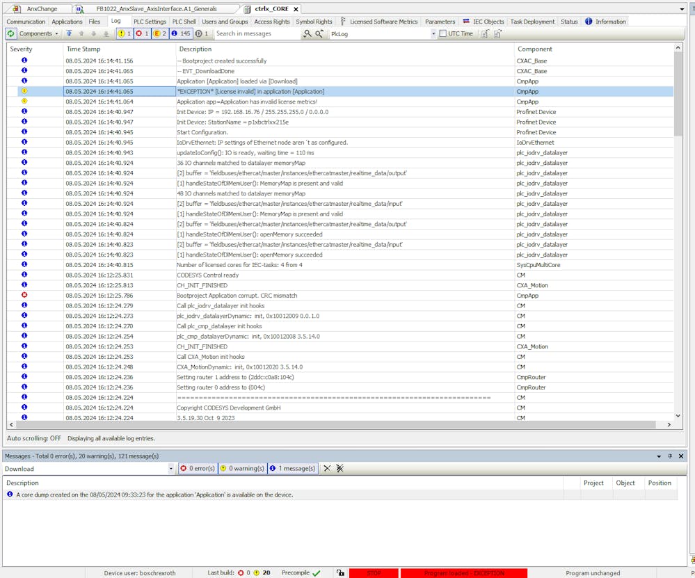

After a reboot the PLC program is gone (no application on device), and after i re-download the PLC program I get the exception "No PLC licence", after this I need to perform a reset ORIGIN and re-re-download the PLC program.

Like mentioned by the error description this special mode is triggered when a realtime system exception occured. This prevents a permanent boot loop and gives the opportunity to check for the root cause. A reboot is mandatory in that case, like also mentioned in error description.
The lost PLC application is because of a incomplete download. See error message in PLC log: "Bootproject application corrupt. CRC mismatch". So it is not available, as it is broken and so ignored.
The license error is a known bug in the version 2.4 of the PLC Engineering, like mentioned in the official release notes and some other topics in the community.
