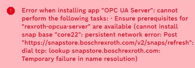

I am trying to install an OPC UA Server app on my ctrlX PLC running Ubuntu Core 20 OS. I would like to ask whether the OPC UA Server app UAS-3.6.7 is compatible with this setup, or if I need to use an older version, such as UAS-V-0120.4.

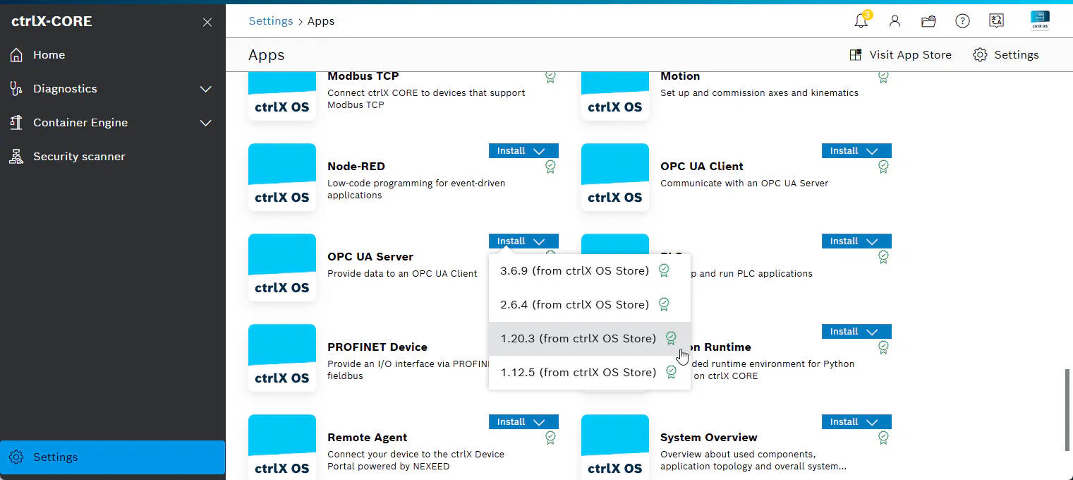

if you got a ctrlX CORE based on Core 20, the OS on the System is either V1.20 or V1.12. You can check that if you have a look at the System Apps Versions (like the Device Admin App).
The OPC UA Server App in V1.20 and V1.12 can also be found in the Collaboration Room: https://www.boschrexroth.com/de/de/myrexroth/myrexroth-home/collaboration-rooms/?path=%2FCtrlx-Automation%2FctrlX_eShop%2FctrlX+CORE+-+OPC+UA+Apps&page=1&search=
Or if your ctrlX CORE is connected to the internet you can also directly download and install it from the ctrlX OS Store on the device:
