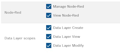

I setup a dedicated nodered user with limited permissions, but now I can't browse through the datalayer to find the data that I'm looking for.
I've given it these permissions: (and a bunch of others)
What else do I need to give it so that it can access and edit the datalayer?
