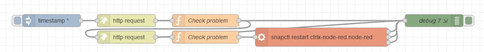

I was able to reproduce the issue, we are trying to find  a fix that maybe will be included in some next release. Meanwhile can you check if this workaround is fixing the issue:
I am waiting for your feedback.
Mauro
