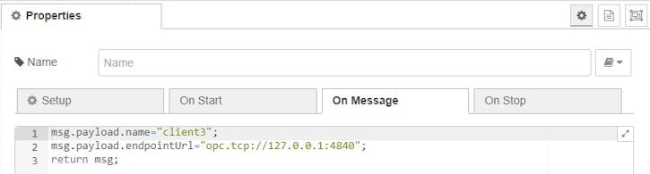

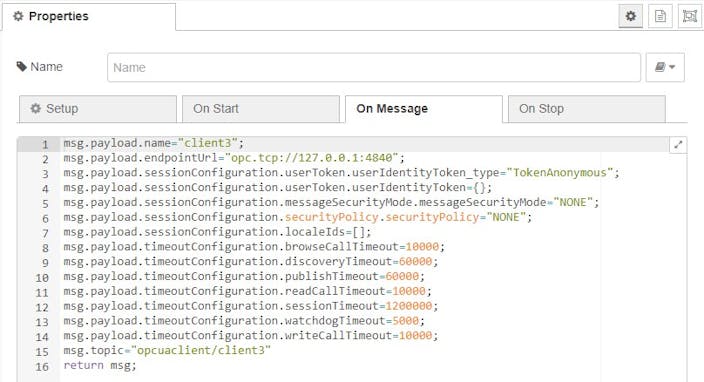

In node-red I would like to create a new client. On the documentation of the OPC-UA Client is written that the name and the endpointUrl are the only mandatory input, everything else is optional.

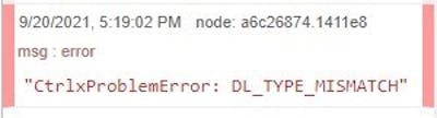

I tried to create a new client both with only the mandatory input and with all the input, but the debug gives me this error: "CtrlxProblemError: DL_TYPE_MISMATCH".
These are the two configurations:
All Parameters:
Mandatory Parameters:
Why the type mismatch error? What am I missing?

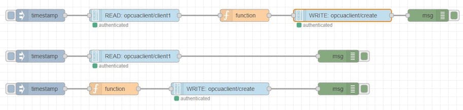

I think at least you are using not the correct input to the Data Layer node. It is expecting a specified strukture. You could have a look to this topic for some examples.
EDIT:
var newMsg = {};
newMsg.payload = {
      "type":"object",
      "value":{
	    "name":"client3","endpointUrl":"opc.tcp://127.0.0.1:4840"
return newMsg;
