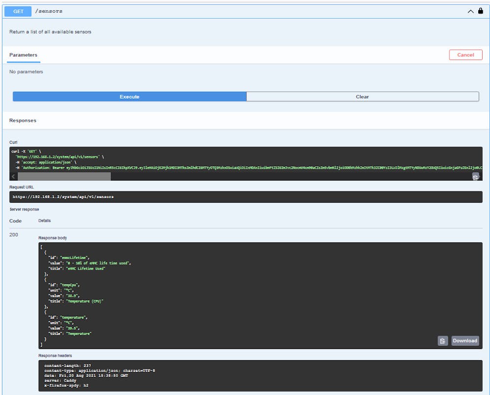

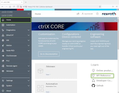

For the internal sensors you have to use the system API. Please the corresponding description on your ctrlX CORE landing page under "API references:

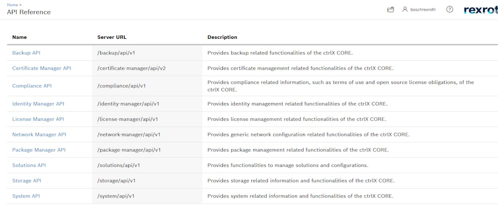

There you find a list of several APIs:
And you can directly try them:
