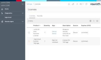

Hi! I'm encountering a warning sign in the Licenses section of the Core Settings page. The license is for our snap which is sideloaded on the device for validation. It integrates with the Core's licensing system.
The license works fine on our end but the Core's Licenses section shows a warning for our corresponding license and the App field says: App not installed.
Seems like our app is not detected, maybe there are some fields I am missing in the manifest but I can't seem to find them. I woul appreciate any help 🙂

Two remarks:
  1.  does the id in the package-manifest match the name of the snap from the snapcraft.yaml?
  2. does the package-manifest have the name: "<id>.package-manifest.json"?
    (With V2.6 there was a change here to improve the boot time of the controller. Since then the name is mandatory).
