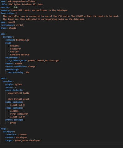

The snap was working perfectly on the X7 on the older Ubuntu Core20. Nevertheless, we updated the hardware to the newer ctrlX OS 2.2 (ubuntu core22) version. The snap had to be adapted, due to the newer ubuntu core version. Furthermore, a newer SDK and ctrlX Works (ctrlx-automation-sdk-2.4.3) were used to create the new snap, because the older one (ctrlx-automation-sdk-1.18.0) did not allow core22 snaps to be created. The only modification made to the newer version was changing the base to core22 (see picture).
When running the snap on the X7 the LibUSB library is once again not being found. The next picture shows how the library path is defined. Nevertheless, the snap does not find the library. The older snap uses the library libusb-1.0-0_1.0.23-2build1_amd64.deb. The current library being used by the newer snap is the libusb-1.0-0_1.0.25-1ubuntu2_amd64.deb
I have tried defining the path multiple times, but none seem to work. (.../libusb-1.0.so.0.3.0, .../libusb-1.0-0_1.0.25-1ubuntu2_amd64.deb ,.../libusb-1.0-0). Any advice on this problem?

Try changing the path to   .../current/usr/lib/x86_64-linux-gnu/libusb-1.0.so.0.
In my case (snap=rfid-card-reader) the path was redefined as:
