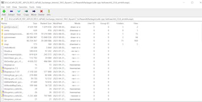

As we can see,in the packaged snap file,there are library files i need
but when i downloaded it into the physical core,the log file told me that it could not fing the lib files☹️

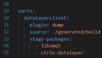

You can see from the other cpp-samples in the SDK, that we are using the stage-package mechanism from snapcraft to pack our dependencies into our snap. Here for example the Data Layer client:
stage-packages in the snapcraft.yaml

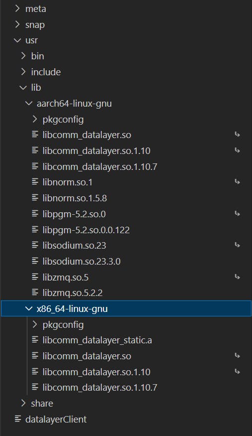

If you do it with stage packages it looks like this (screenshot from the unziped sdk-cpp-client-arm.snap):
I think you should probably try it the same way.
