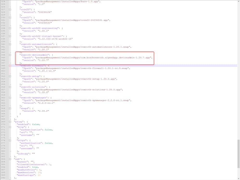

  2. Unpack the setup file and make following changes
    1. Copy the Device Admin archive you just downloaded to the folder 'packageManagement'
    2. Open the ctrlx-setup.json file and replace the information within the Device Admin (rexroth-deviceadmin) application section
      1. Adapt the path under the rexroth-deviceadmin app entry to your previously copied binary name, e.g. "$path": "packageManagement/installedApps/Device Admin XCR-V-0120.7.app"
      2. Change the version under the rexroth-deviceadmin app entry to the version of your previously updated application, e.g. "version": "1.20.7"
  3. Add all files of the previously unzipped setup file to a new archive, e.g. "new_setup.zip" which can then be applied to your device causing the Device Admin application to be upgraded to the mentioned version
  4. Re-apply the license file that was issued for the device (if not already included as part of the setup process)
The following screenshot shows an example.
The following screenshot shows an example:
