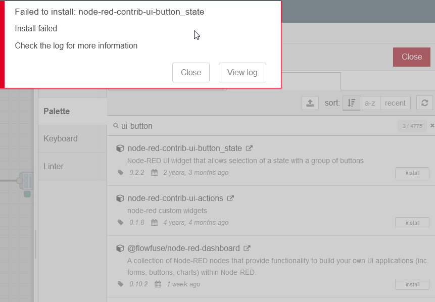

Install node is failed in node-red
hello:
I am trying to install 'node-red-contrib-ui-button_state' in node-red,but not sucsseful.
the core's time is taken from my computer's time, system version is 1.20.
the error message:

Best reply by Sgilk
Hello LZT ,
This is due to a lack of internet access on your ctrlX CORE. See this post for more information.
If this is a physical CORE, make sure the device is networked to a router with internet access. See this post.
