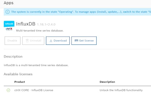

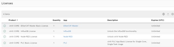

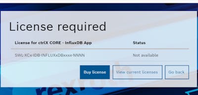

i have aqquired the license with the InlfuxDb App. So i upload the app as well as the license after activation of course in the license center. If i want to open the app it apperas that i do not have the license.Β
See screenshots please.Β

It is solved. The date/time was not adjusted properly . My fault. Thanks anyway πŸ™‚Β
