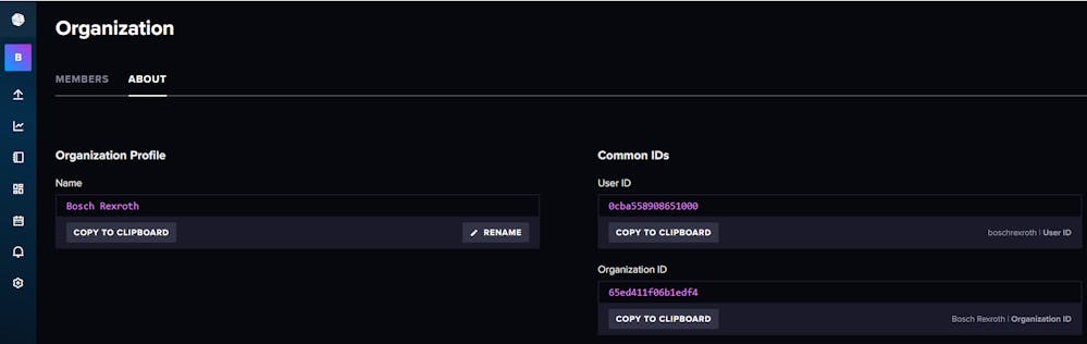

Here is an example request in Postman. You can find the orgID in the Influx web UI under organization about section.

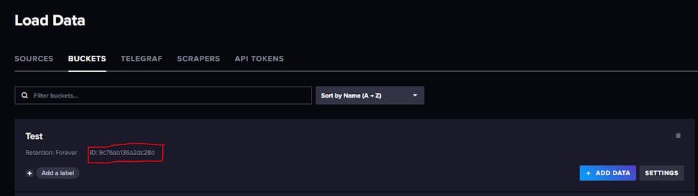

You can find the bucket ID on the buckets page.

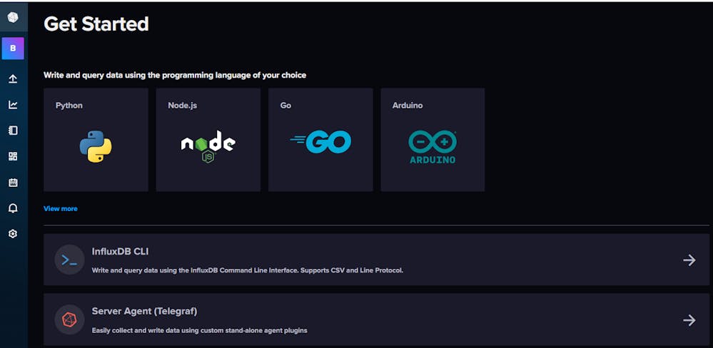

On the Get Started page of the InfluxDB web UI, there are instructions to configure the CLI. I'd recommend using the REST API however, as they have almost all of the same functionality and it does not require any client side installation.
