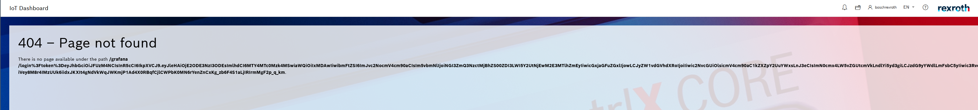

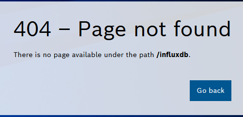

Influx DB and IoT DashBoard: 404 - Page not found Error
I installed the latest pre-release versions of these apps but when I try to open them I get the following error. I tried to update the system apps but the situation is still the same.

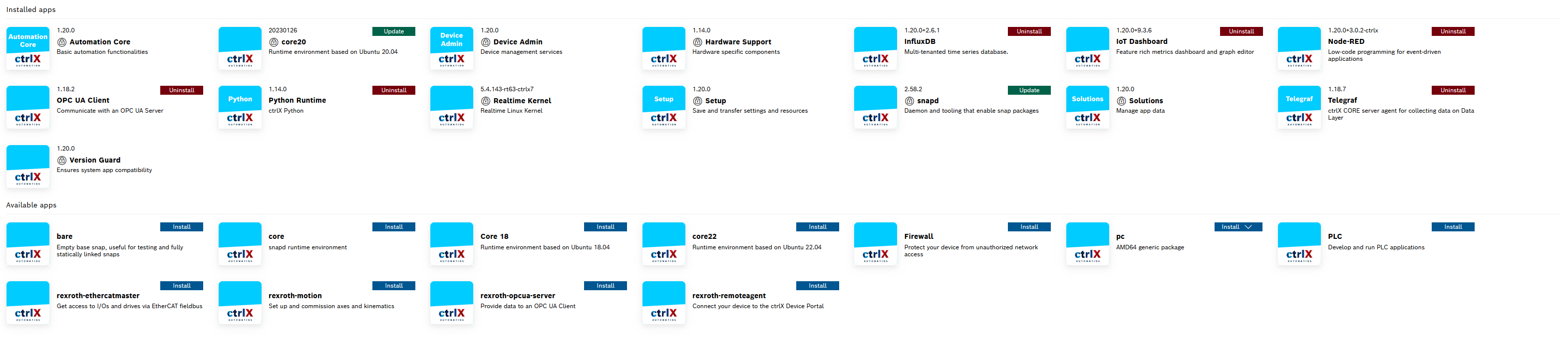

For IoT Dashboard V1.20 and InfluxDB App V1.20 its prerequisite to have the System Apps V1.20. Maybe there is an issue with first installing the Application Apps and afterwards updating the Sytem Apps.ย
I would recommend to uninstall and reinstall the InfluxDB and IoT Dashboard Apps.ย
